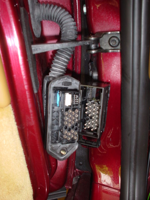

You will first have to figure out how you are going to get wires inside the door. There is the connector unless you wanted to drill holes. You would have to get the correct male and female pins. Then I guess you would tap into the overhead light so that the door lights would go on when the overhead light goes on when you open the door.

But, I still would like to do this and I'm fairly certain that I could carefully wiggle the wires up through the rubber tube between door and body.... patience is a good thing (or maybe I have too much time on my hands!).
