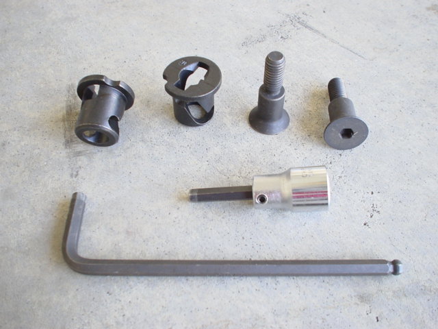

All 986 hardtops interchange with any year. 1997 and had the "ears" but this has nothing to do with how it fits.
The parts you need to mount the top are the 2 inserts and 2 bolts shown in the picture.

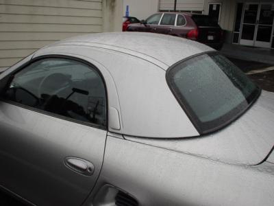

Just one question - What do you mean by ears? Does it not look nice?

This is an "ear." The cover was removed for mounting the roof rack. Then Porsche decided it was not necessary when mounting the rack to attach it to the hardtop, so the ears went away.
