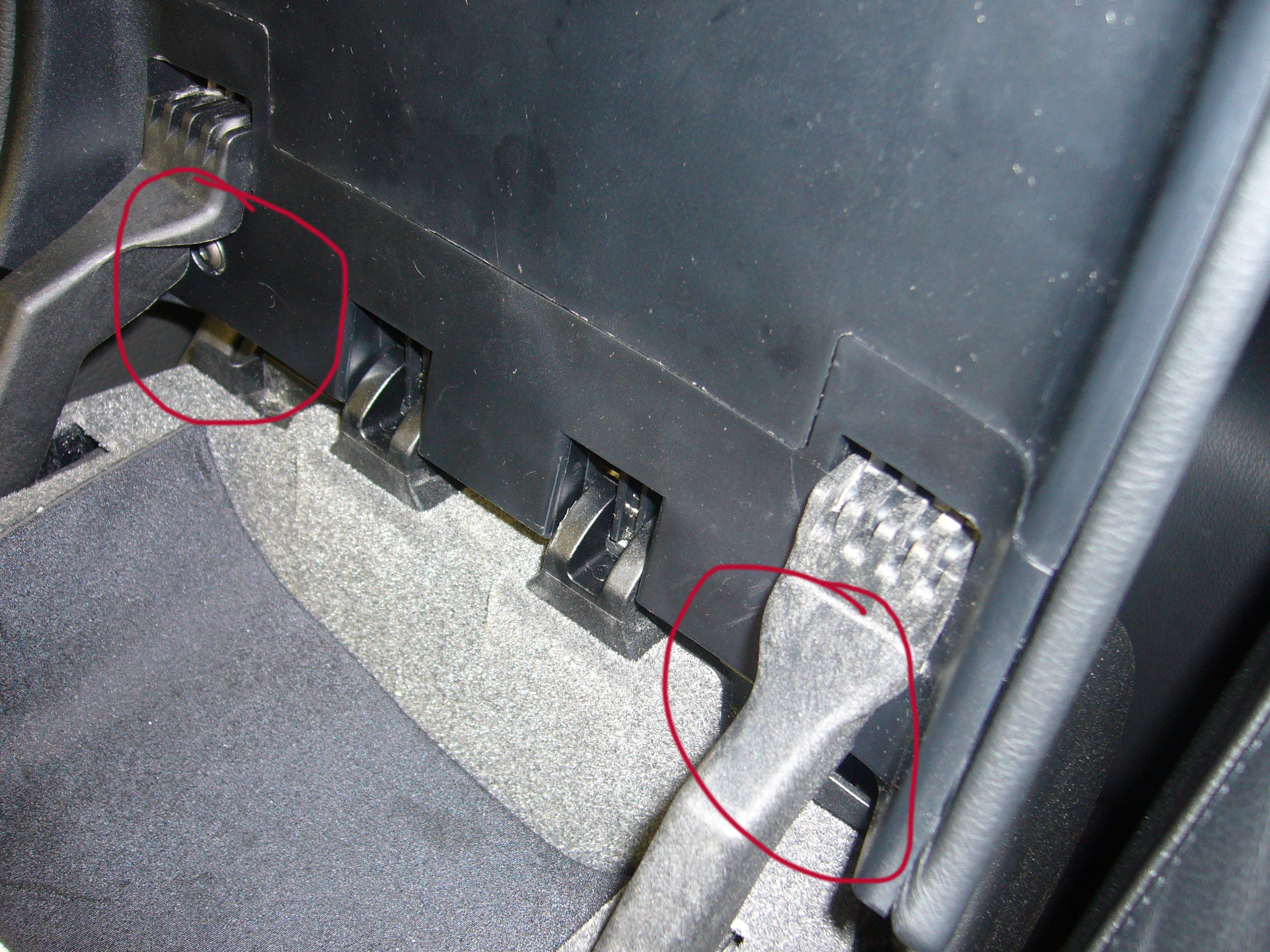

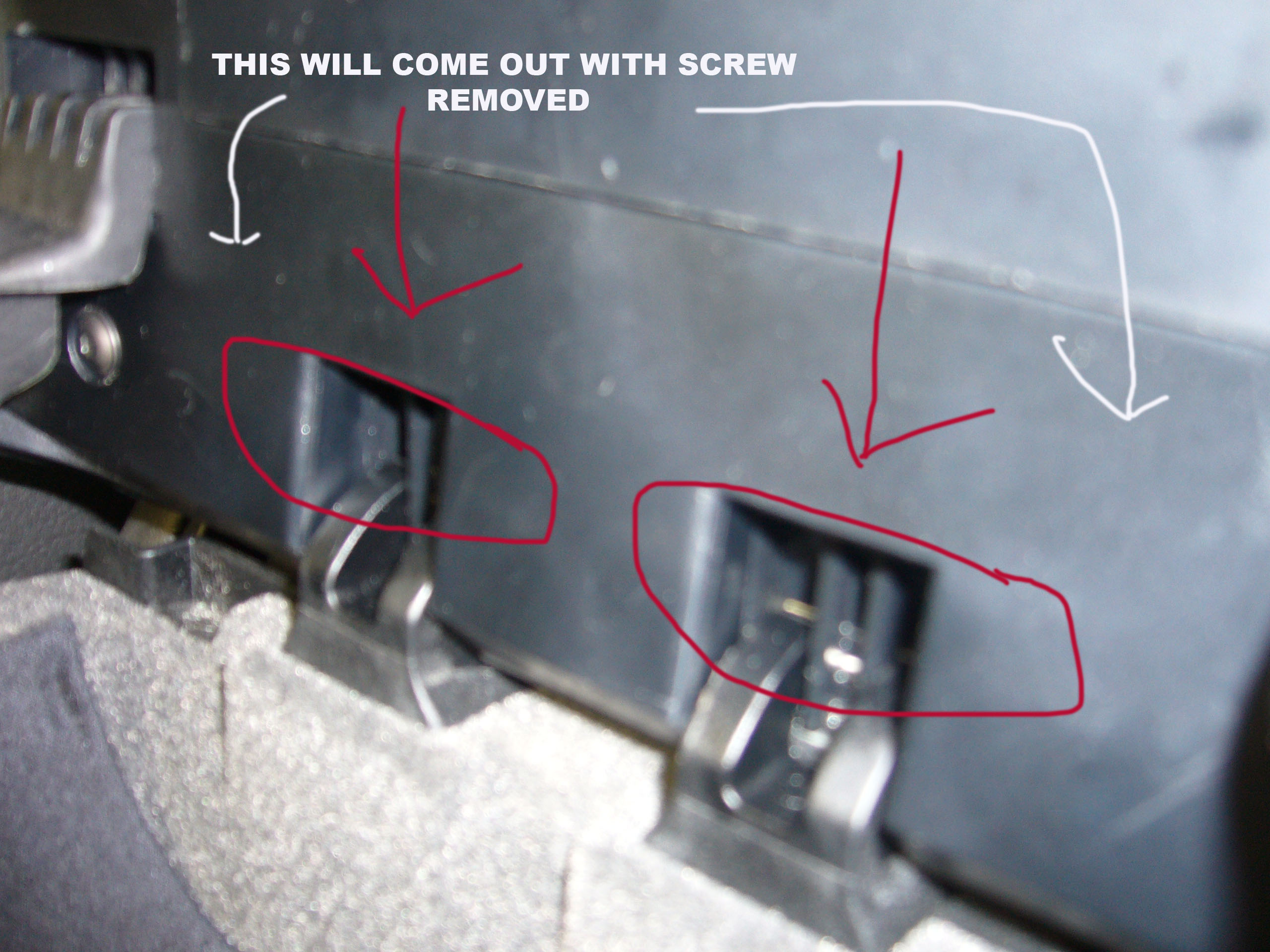

First Start By locating the two screws behind the supports of the armrest
Once you locate them use a T20 or 25 to remove them (i pulled the armest closed a bit for easier access to remove the screws)
Once those are removed the middle section of the supports will pull forward (with some force becareful they are held in by plastic clips)
Then for the hard part this is a PITA !!!! You must remove the 2 metal cotter pins which i really have no advice for you other than BE PATIENT !!!!!
Remove those pins with a pliars and flat blade screwdriver....then the top half of the armrest will come off
