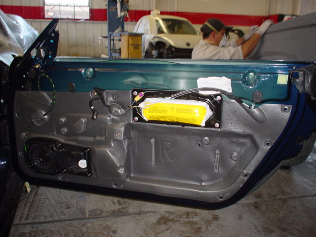

Right now, I already have the door panel removed.
Now I'm also thinking of removing the airbag, coz' I don't trust them removing that and leaving it in a corner, or underneath a pile of whatever, getting scraped, or punctured.
Question is, if I remove the airbag and reconnect the battery to drive the car over to them,
That is gonna trigger an airbag light, correct? Is this all there is to it, the airbag light?
Is there any caution that I should know of, starting or driving the car without the door airbag?
Then later when I get the car back, and install and reconnect the airbag back on the door,
Will the airbag be in good working order as before?
Will the airbag light just go away, or do I need the dealer to reset it?

If you disconnect an air bag and turn on the ignition the light is going to go on. When you hook up the air bag the light will still be on.
Toolpants, does the dealer just have to simply reset or clear the airbag light,
or is there some programming to do in order for the airbag to work correctly.
Thanks for the reassurance, Toolpants! :thumbup:
At least I feel better, and safer, knowing for sure it's just a light and nothing complicated.
