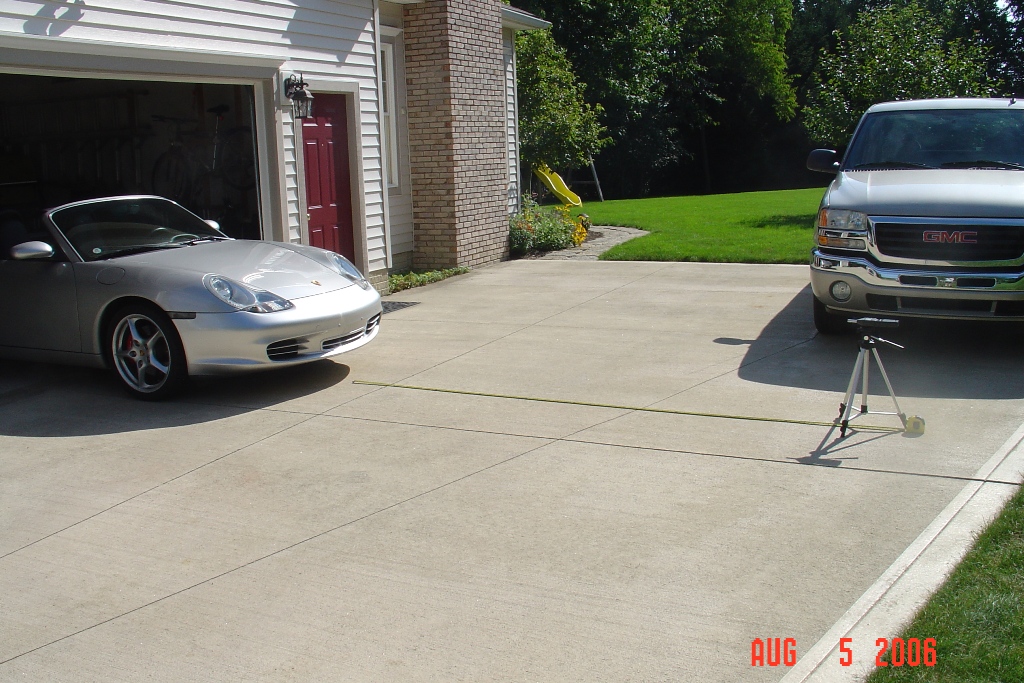

Before I did anything, I borrowed a basic sound pressure meter and set it up on a tripod 10 feet from the front bumper like this:
Here is the data:
BEFORE (OE Horns):
Ambient Noise:... 51 dBA peak
Hand Clap:......... 88 dBA peak
Horn:.................. 95 dBA peak
AFTER (Hella Supertones):
Ambient Noise:.... 50 dBA peak
Hand Clap:.......... 86 dBA peak
Horn:................. 100 dBA peak
I did multiple trials to make sure the results were consistent, which they were. The hand clap was me standing in front of the car, clapping my hands as loudly as I could. I also put the meter 10 feet in front of my GMC, too, just to see what it was....93 dBA. FWIW, the ambient noise measurements seemed right to me, but the hand clap data seemed too high. Since I used the same equipment, set-up, etc., I figured the before/after measurements would be good enough to determine the delta, rather than worry about the absolute values. The meter was a bit on the low-end scale, not a high$ Bruel & Kjaer, for instance.
Anyway, the Hellas do seem louder, and test out at about +5 dBA. But my one complaint is that they are still a little "tinny." Still more of a "beep," than the "honk" I was after.
