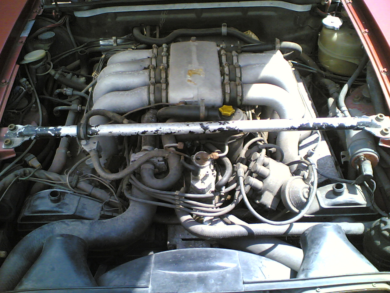

Just got a EURO spec 928S 1983MYR ..been standing for 4yrs and i'm in the process of going thro the non start issues.
Had stale fuel and system is gummed up (nothing to serious) ..Replaeced pump and filter... got fuel to fuel dist...found return pipe blocked with fuel gum..
CAREFULLY removed and stripped out Fuel distributor.....nothing to bad corrosion wise inside marked up everything for reassemble.
1). Does anyone know where i can get a service kit containing :- 8 OFF O-RINGS for the Control plunger barrel (small 5mm to seal to the up casting outlets to inj union's)...Main O-rings 25mm to base or Control Plunger and seal (looks like any Onion skin type. FYI the Bosch pt no of the fuel/dist is 043 120 170
Have tried DELOREAN but they want $600 !!!! for a service exchange unit :huh:
Any tips or help on this would be much appreciated.
