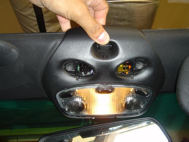

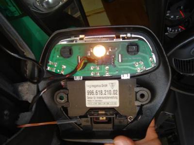

Option #1: the headliner connection point. If I chose this area to get power, which wire would I use to get power from? See pic attached. Thanks
I just did this yesterday in my '02 Cab. In your first pic, the connector with 3 wires one is power and one is ground. I used those. They are constant on so you will have to manually turn the V1 off when you leave the car but no big deal really. Plus leaving the V1 attached to the windshield is an invitation to thieves anyway...
