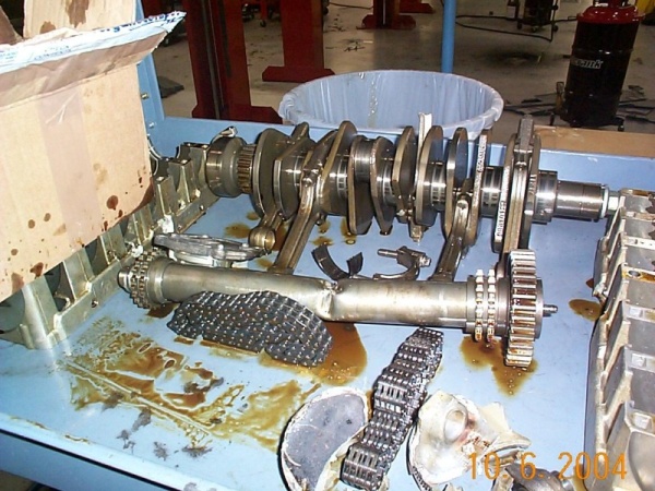

Intermediate Shaft Failure
The intermediate shaft is supported by a bearing on the rear of the engine. This shaft drive things, like the cams via chains. The bearing was a double bearing then Porsche switch to a single bearing. When the bearing fails it damages the engine. I think this change was made in 2001.
Don't know of any way to prevent it since it is a design issue.
You hear a noise like marbles in a can then the engine stops. A nut on the end of the shaft shears off which leave a hole in the back of the engine for oil to pour out. It is too late for you to do anything.
That is the way I understand it.
