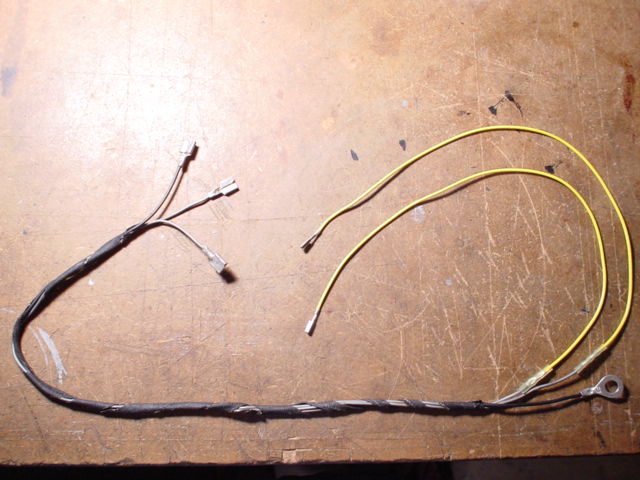

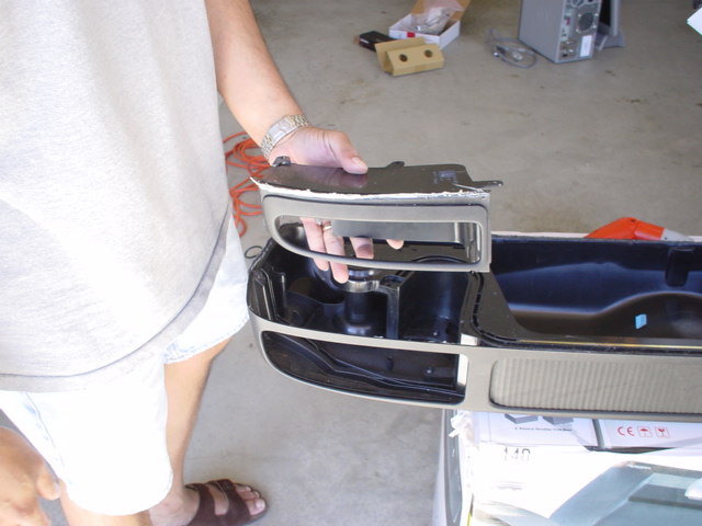

You can do both projects at the same time, to save time. That is the way we do it when a dozen cars show up and there is a time limit to finish because you are at someone's house.
While someone is preparing the rear storage box for the speakers, someone is pulling the body trim pieces to run the wiring harness to the radio head (for 2002 and older). Raman has a dremel to cut the glue for the rear storage bins.
For the OBC with switch, someone makes the wiring harness while someone pulls the cluster and switch trim. For a 2001 with switch you need one VW wire 000 979 009.

Although I doubt we will even have half a dozen cars show up, that is a good idea TP! I made the wiring harness one evening when I had time, but there are a couple others who may need it done, so we will follow your suggestions. I also have some spares that I will bring that day (not the VW wire or the button, but everything else).
Jeff: Speaking of VW wire, I had used the supplies list on Whiteson's page, which lists the part # for the VW wire as 000 979 010 - slightly diff. from the part number you mentioned. Do you know if the 010 will work? Btw, I've also gone through the OBC hack archives on this forum - I have an interesting story to share with you when we meet next :)

Yoseif Whiteson was a local Boxster owner I knew 100 years ago. The use of VW wires was something that Peter Smith came up with. Peter gave me the instructions for the stalk retrofit and I gave them to Yoseif.
The instrument cluster changed in 2001. The 000 979 010 wire used for 1997-2000 did not fit as good as the 000 979 009 wire in the 2001 up instrument cluster connector. I then spoke to Peter and the instructions were amended for 2001 up. Yoseif did not get the amended instructions.
In reality, either wire will work.
The rear storage bins are held in place with a bead of glue. Sometimes you can peel the glue away with your fingers, utility knife, chainsaw, whatever will break the glue bond. On my 1997 with a retrofitted 1999 box I was able to peel the glue away with my fingers. On other cars the glue bead is solid and you need to cut it. Remove your box and take a look.

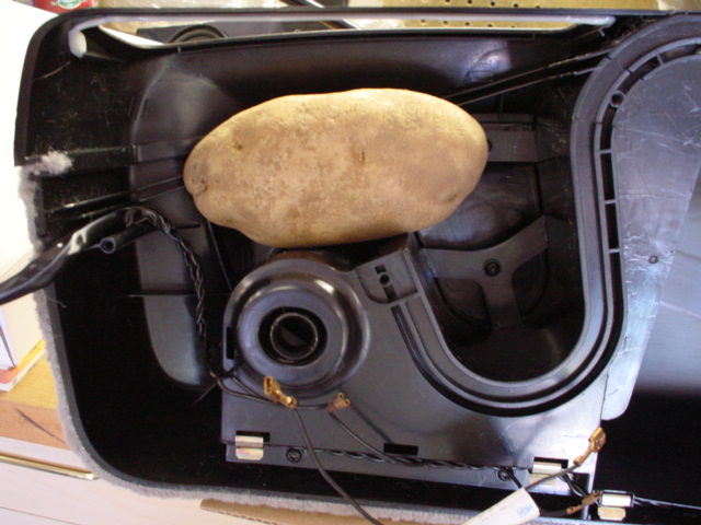

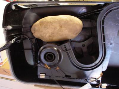

If someone can get a virus out of my notebook computer then I will bring my potato speaker....
TP, first off, what in the heck is that thing? :) I see wires and a potato inside the speaker box, can't wait to hear what it sounds like ;)

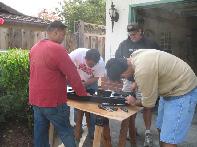

Thanks to Efren for hosting this.
4 guys working on the storage/speaker box. 4 dremels were there, but no dremel was used or harmed. And they did it.

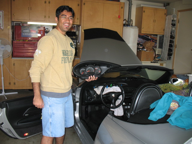

Varun holds his instrument cluster like a fish he just caught.

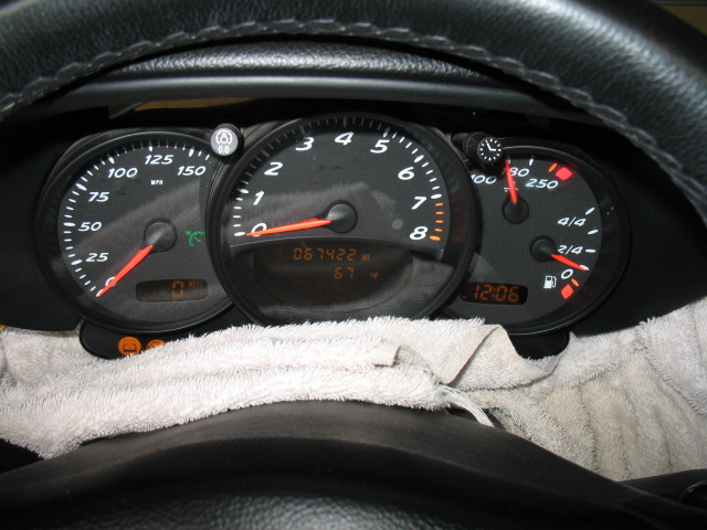

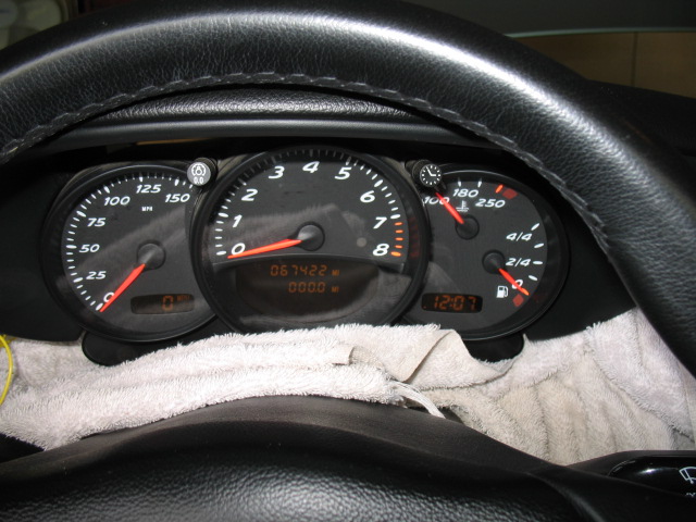

We tested the theory for a different OBC "hack" for 2001-2004.
If you are only interested in seeing the outside temp display when the ignition is on and do not want to do the switch or stalk retrofit, then you run the 009 wire from slot 23 in the gray connector and ground the other end of the wire. When you turn off the ignition the display reverts to the normal trip odometer display. When you turn the ignition on you see the outside temp display. The ground end of the wire must be connected to ground when you see the temp display.
If you are only interested in seeing the outside temp display when the ignition is on and do not want to do the switch or stalk retrofit, then you run a wire from slot 23 in the gray connector and ground the other end of the wire. When you turn off the ignition the display reverts to the normal trip odometer display. When you turn the ignition on you see the outside temp display. The ground end of the wire must be connected when you see the temp display.
Thanks to Varun for being the guinea pig for this test

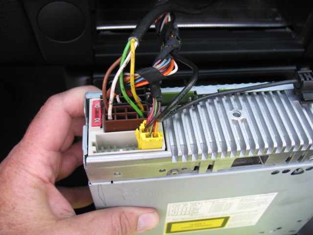

There are 4 wires that go to the rear speakers. The pre and post 2003 instructions from Porsche reference them as green, red, and 2 black (ground) wires. In the prior rear speaker installs we did those were the colors.
With Varun's factory rear speaker kit, however, the wires were brown, yellow, white, and green. These wires go into the brown connector that is included in the kit.
Guess Porsche/Becker ran out of red and black wire when Varun's kit was made....
