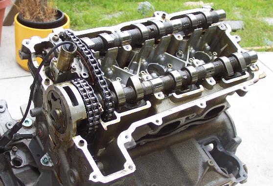

I don't think I have any pictures. I did see this picture on a photo hosting site, but I don't know who took it. Please note the engine is on a stand and has been rotated.
Thanks Tool Pants, that really helps.
Its hard to tell, but it does look like the cams are sitting slightly out of their journals at the far end, but I guess that is to be expected given how they are held in.
At least it seems the cams wouldnt just flop out if the cam cover was removed, with the engine still in place in the car.
