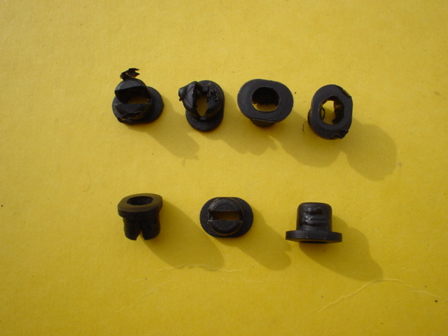

I went to the dealership because I am attempting to replace the windstop clips on my boxster 1998. They told me that I had to buy the whole roll bar pads. Does anyone know if the clips/ bushing that holds the roll bar pads in place can be purchased separately or if you know the part number so I can take it to the dealership...Thank you

If this is what you are looking for then the part number is 986 580 751 00.
Thank you! That is exactly I was looking for. I don't know why the dealership can't find the part number for it. THey keep on insisting that it comes with the roll bar pads...Thanks again!! :) :renntech:
