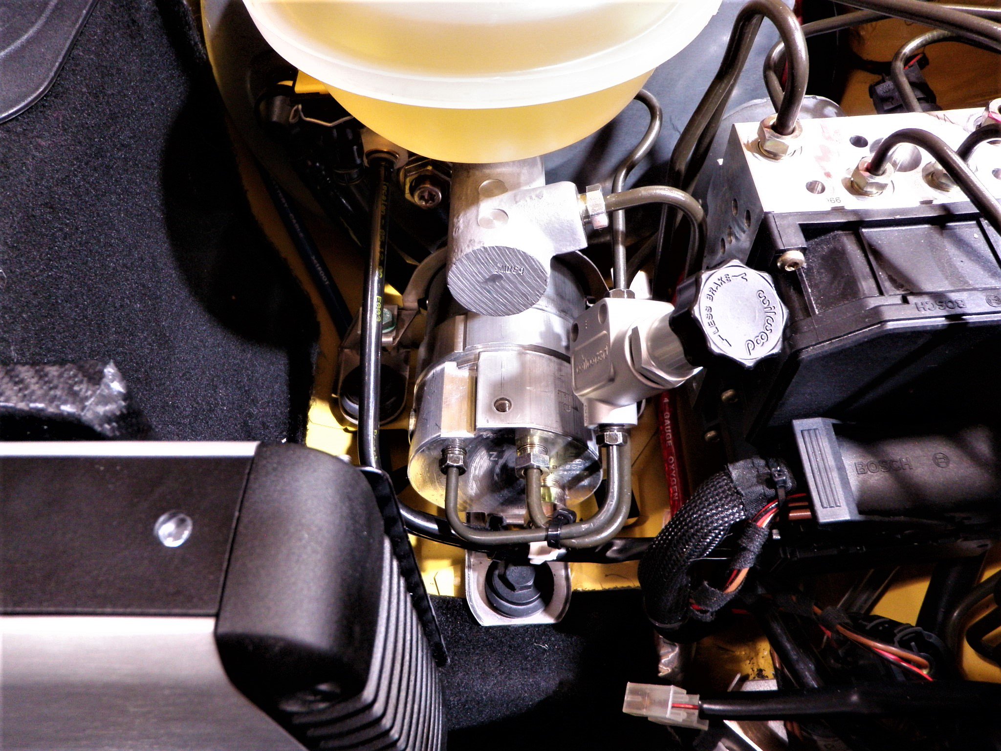

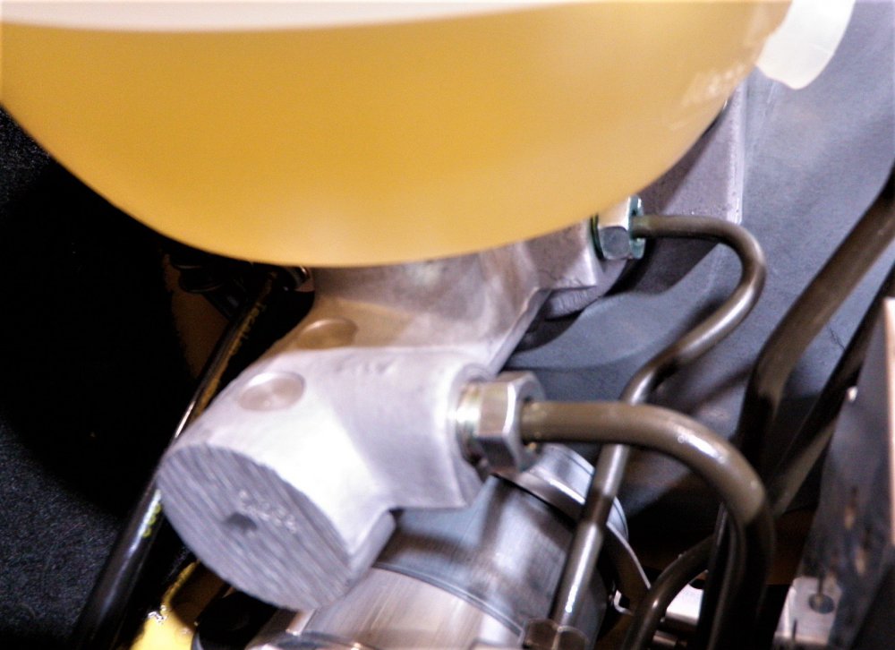

If you add the 997 GT3 master cylinder (27mm bore) to the 996  in order for the psm/abs to work perfectly and not throw any codes you will need to install a brake bias adjuster in line between the rear master port and the psm pump, it needs to see about 7% reduction in pressure or it will throw a psm/abs code and shut down the system.  Note the 997 gt3 master has both ports 12mm bubble flair, unlike the 996 masters that use 12mm front, 10mm rear so you will have to make a custom line or a adapter (they suck)   Anyway it gives you a rock hard pedal with the 997 or bigger brakes and all works as it should
