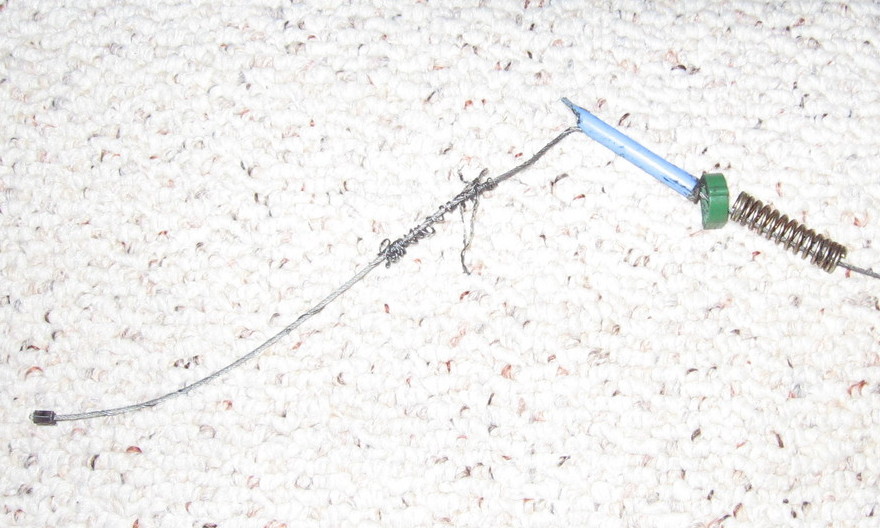

Lee,
It starts out as a squeak and gets progressively louder until the window just quits working completely. My drivers side failed and one month later the passenger side failed. Upon disassembly, I found both cables frayed (see photo). The passenger side gave a bit of warning prior to the squeak by not dropping automatically when closing the door. It took me about 1.5 hours for each side.
