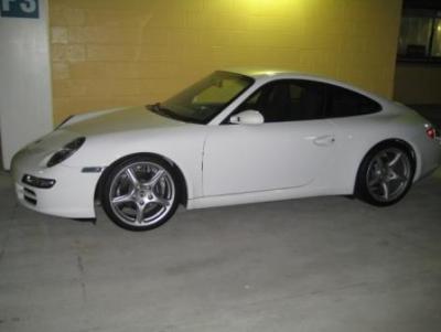

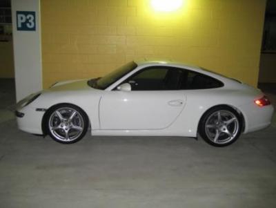

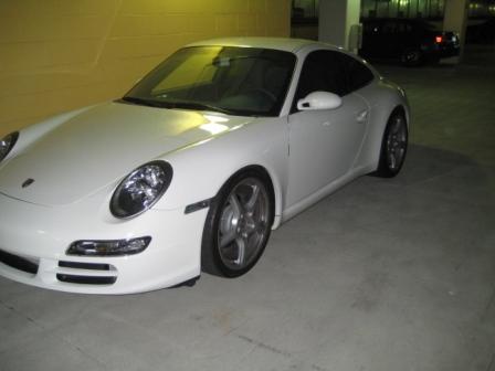

I have a 997 and did the exact same upgrade with c4 carrera classic wheels with 11x19 ET51 on rear with the 305 michelins dropped with H&R springs. They fit perfectly without any rub. I also had them on with the stock suspension and there weren't any problems. Some might say that they may look a bit too aggressive but they in fact are almost the exact same offset as the techart formulas for the porsche which in my opinion look great on the 997s. (They are only 1mm wider offset). The other nice thing is that you wont need to add any spacers for the rear. The fronts are the exact same wheel as on the regular carrera so they will need some spacers to bring them out a bit. I recommend 7mm.
Here are some pics
