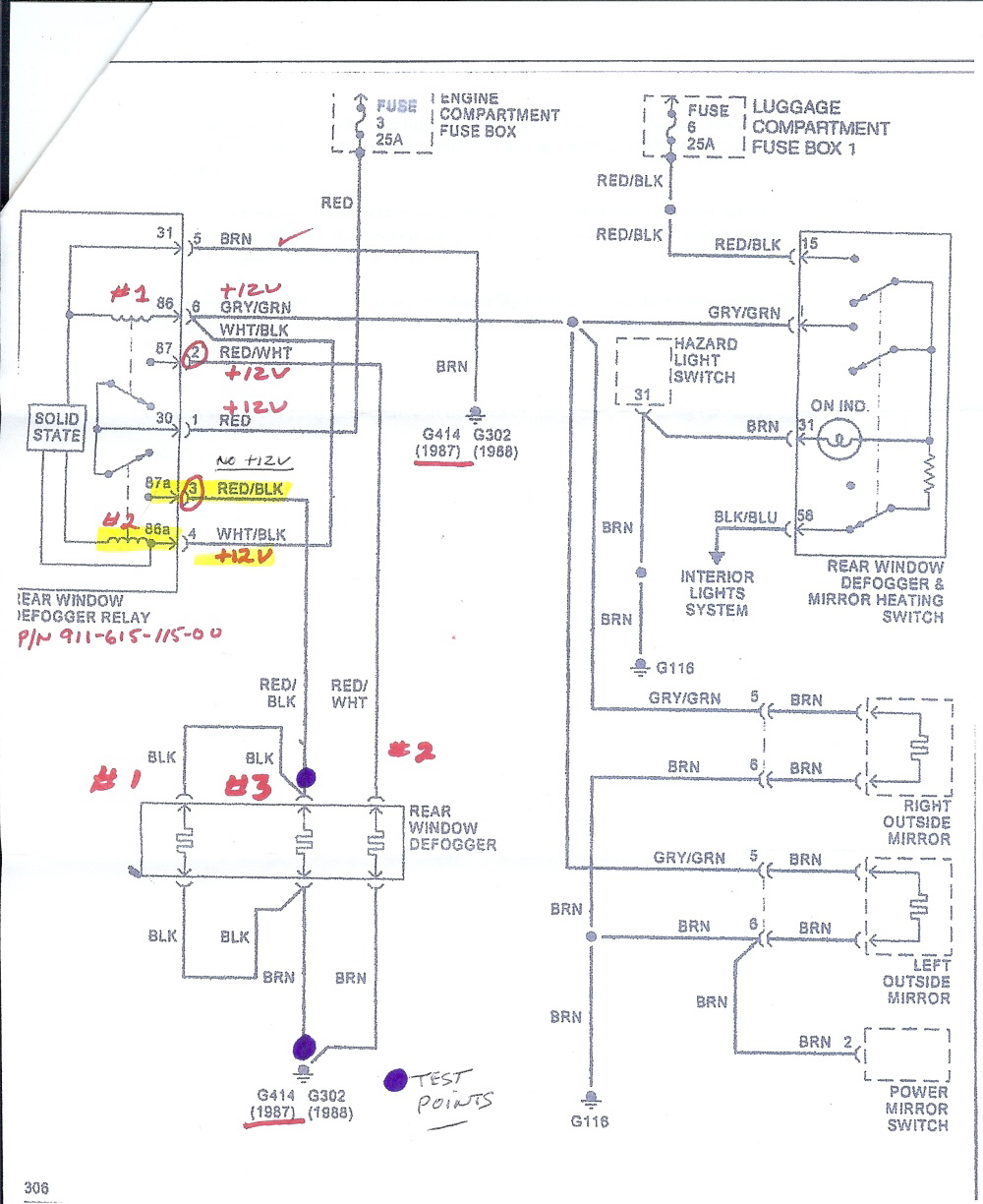

The upper and lower defogger elements on our '86 Targa do not activate.
The following troubleshooting steps have been taken.
1. The defogger relay has been replaced. P/N 911-615-115-00.
2. Independent continuity checks have been performed from each element to ground, (let's call the upper element #1, center #2, bottom #3), and indicate continuity to ground.
3. Voltage check on harness contact(s) number(s) 1,6, & 4 confirm 12 VDC.
4. At no time is there any voltage on relay contact # 87a (harness contact # 3).
It has been confirmed that relay #2, which applies voltage to the above contact does not ever energize.
How & when the solid state circuitry activates relay # 2 is somewhat confusing, and our local dealer/mechanics
do not know when or how relay #2 engages.
I have done everything a dealer would do.
Any thoughts out there?
