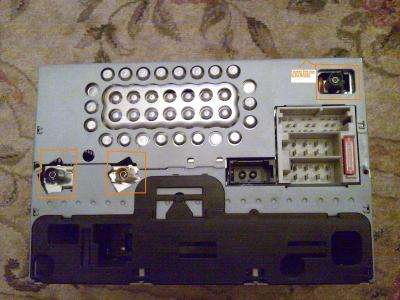

as I\'ve stated in the title, I\'m kind a looking for some help here also. so Long story short - I have found myself owner of an almost new PCM2.1 for Cayenne from my cousin who had it laying around for some time and also no use for it, at no cost at all in a point in which I have almost forgot the ideea of comuting from RC to an AV sistem, my car has the BOSE sistem installed and as far as I have read it helps a bit. Please tell me in order to complete the sistem what else I would need:

- what are those plugs in the pictures for? antenas for gps, phone and radio?

What you have is the head unit only
You will need the under passenger seat DVD player and a large number of components, wiring and fiber optics. inluding front to back wiring which will need you to take most of the car apart
Does your car have PCM2.0 already ? I get the impression not. My advice is to sell it on ebay and buy a TomTom its a horrible job to do and it may never work.

so, the car has already the Bose suround sistem which is the same for every one: its FIBER OPTICAL based one and its the same one that is used also for RC's and Navi ones like PCM 2.0 or PCM 2.1. so I dont have a problem to conect it to the car right now and play the Radio or the CD if you are thinking about audio conection problem, but I dont have the other DVD unit for Navi - I thought that the NAVI on PCM2.1 is DVD based; I mean the head unit is a dvd based one or I'm wrong? I dont want to use a Tom Tom, because I'm not addicted to navi, I have a small GPS that I use for that, I wanted it more for display and FITTMENT, cause if you look at those that are using different HeadUnits you will see that it doesnt look good at all, because the adapter frame is uglly as hell- the only one that is looking good because it isn't just a flat piece of black plastic costs around 450$, I'm not willing to pay that amount for a plastic, I'm willing to pay more than that in order to have the sistem working. And thats why I have asked what I have to do, if someone has already did it or know what parts I have to get, a electrical diagram will help me also, and as i stated before everything that you think it will help me please dont hesitate.

You will need to run cables from the front of the car to the rear spoiler to install GPS Antenna, you will also need the hardware to go with it. There is a TSB which describes how to install PCM to a car with regular head units. Its available to contributing members of this site. I think it gives a parts list.

An update for others, I have installed the PCM2.1, and have to tell that its just plug&play, but for some reasons the TFT is fadding so I have to pull it out and order a new TFT for this unit :). In a few days I will have an almost new PCM unit :). I will make a full thread with pictures an how to do it and what do you need in order to repair the faulty PCM units, also the PCM2.
