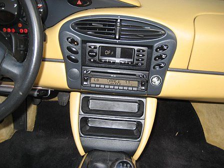

Hi everyone, straight up im a noob with these things. I want to install that garage opener thing, and everyone says its so easy, but it looks so **** hard! WTF?!?! i also wanted to add 2 more buttons to the left of he radio because their is nothing their, i was wondering if their is anyone in Socal that could help me with the wiring. I live in San Diego to be exact. Thanks a bunch
I had two blank switches on my 98 2.5L 5 speed. The AC controls in the middle are at the top, followed by a CDR 210 radio CD player and the two blank switches are to the left. The top switch on the left is for TC or traction control.
I put a Targa Switch in the middle position and wired it to my rear spoiler. I can now raise it up and down manually instead of waiting to accelerating to 75 mph. Probably not much advantage but impresses the heck out of friends in my garage. The bottom buttom is wired to my garage door opener. Push it once garage door goes down, press again and it goes the opposite. All are backlite off of the TC switch. I plan on inserting intermittent wipers in the center round plug.

Thats amazing, btw i do not have tc on my car i have 3 blank spots on my left side, where would i wire the lighting for the switches?
