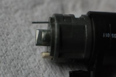

This is a follow up to my previous post - unable to turn ignition key in cold temperatures.
The attached picture shows a bevel on the end of the cylinder - where it mates with the steering lock.
Anyone know if this is worn spot or is it made this way? There is a similar bevel on the other side, diametrically opposite.
Just trying to diagnose the cause of the malfunction. The steering wheel does not lock either.
