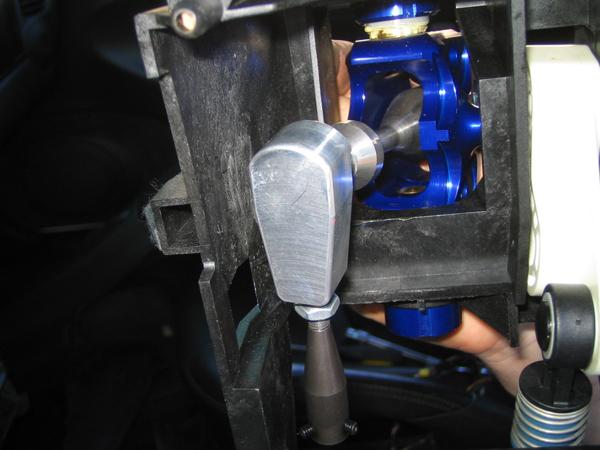

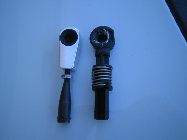

We put in the shift link and B&M in Taian's 2002 2.7. First I put the shift link in while the stock shifter was still in the car. The female ball joint on the shift link is plastic - much to my suprise - I expected it to be made of metal just like the rest of the unit. On the oem plastic cable connector the ball joint is, guess what, made of plastic. In my opinion if there is a weak spot in the shift assembly it is the plastic ball joint. So the critical part of the EVO shift link is plastic. I will say one thing, the plastic ball joint socket on the shift link is a much tighter fit - that fact alone makes the unit worthwhile.
Once the shift link was installed with the oem shift lever it was time to see if we could feel any difference. There were several of us 5 speed Boxster owners there and non of us could "feel" a difference. I also measure the shift throws before and after and there was no difference, and EVO makes no such claim.
Once we were satisfied the shift link was installed and worked properly with the oem shift then we installed the B&M shift. This is the first time I have measured the shift throws on a 5 speed. First to second was reduced by 38.3%, and third to fourth by 46.4%. This is unique as on the 6 speeds the percentage of reduction is the same on all the gears. There are pictures of my measurements in the 996 section.

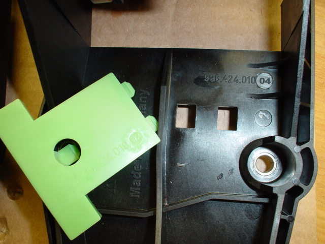

This is the shift link being installed on the oem shift. Once we put in the B&M unit we had to remove the green plate as the shift link was rubbing against it. The shift link comes with 2 set screws but there are 3 holes. We added a third set screw.
Tool Pants - thank you for the excellent photos and impressions of metal shift-link. I was also skeptical of metal shift-link until I helped "boxer6" install Porsche Short Shift Kit in his '99 996 C2. His stock shift link showed considerable wear at the 2 O'Clock postion on the rubber housing (12,500 miles odo). The plastic socket seemed intact; however, if the exterior was already failing - I suppose with time the shift-link could fail. I installed that same Porsche Short Shift Kit on my '00 986 S. There was no wear on my stock shift-link (2,200 miles odo). Since the Porsche SSK comes pre-assembled in bracket with new shift-links attached, both myself and "boxer6" have spare plastic shift-links in case of failure - so buying metal ones would be a waste of money. :cheers: Cheers, you always well informative posts.
The oem cable connector has a rubber coating on it, and I have seen a few where the rubber became torn. But when you clean the grease out of the socket the socket itself looks fine. I assume the coating has something to do with noise or something like that, since it is cosmetic more than anything else. On the next car I am going to play around with the shift lever and figure out if the rubber is hitting something.
When I started out 5 years ago the EVO short shift was the big thing. I don't remember if the B&M was out back then. The reduction on the EVO unit is not as much as the B&M. With the EVO unit the oem plastic cable connector is removed. The EVO short shift unit is all metal. This is why I expected the EVO shift link to be all metal.
I just bought a new cable connector for my shifter, as the old one has a lot of wear on the rubber exterior, I don't want to be stuck somewhere. The new piece only cost $16, far less than the shift link, and it seems a little sturdier than the original.
I've just fitted my B&M short shifter today & I must admit to being less than impressed with the poor quality cable connectors that Porsche use, they look as if they are going to break any minute. My green floor plate seem to catch on the connectors & pull the threaded rod out of the casing so I have not refitted this, don't know whether I'm supposed to or not.

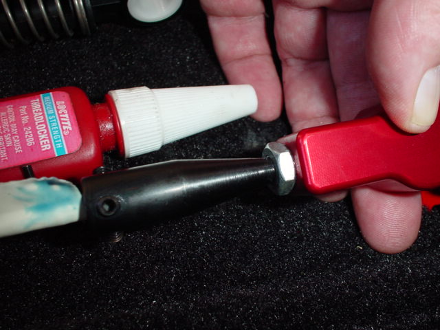

No problem with the set screws. I did use loctite. Does the link still come with 2 set screws, but with a threaded hole for a 3rd? If so I would add the 3rd. Less of a chance of the link pulling out of the cable. You can go to a hardware store and match it up. It is a coarse 8/32 by 3/16".
