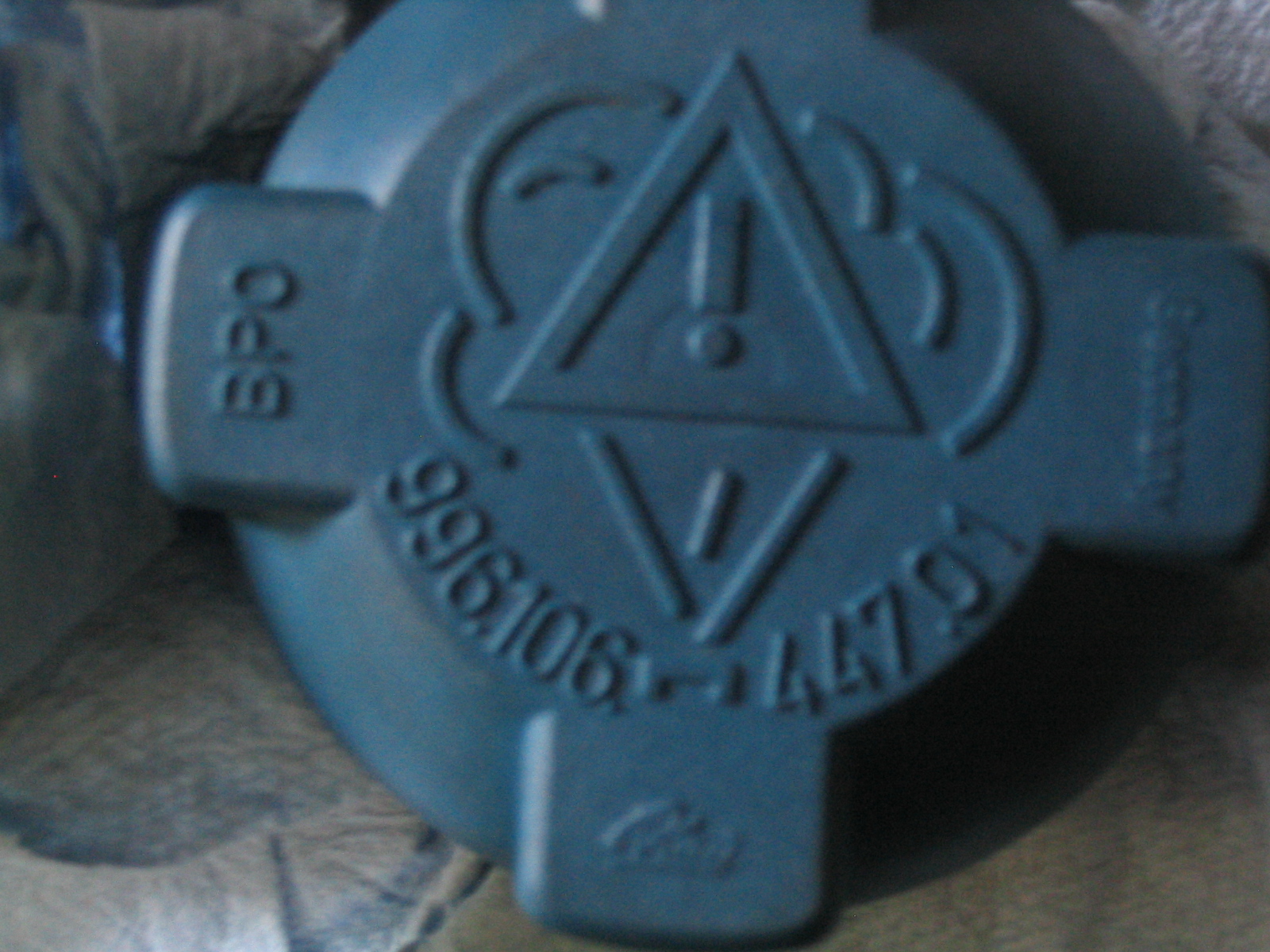

I check my tank cap number and it finish by 01 and there is some moisture on the tank.

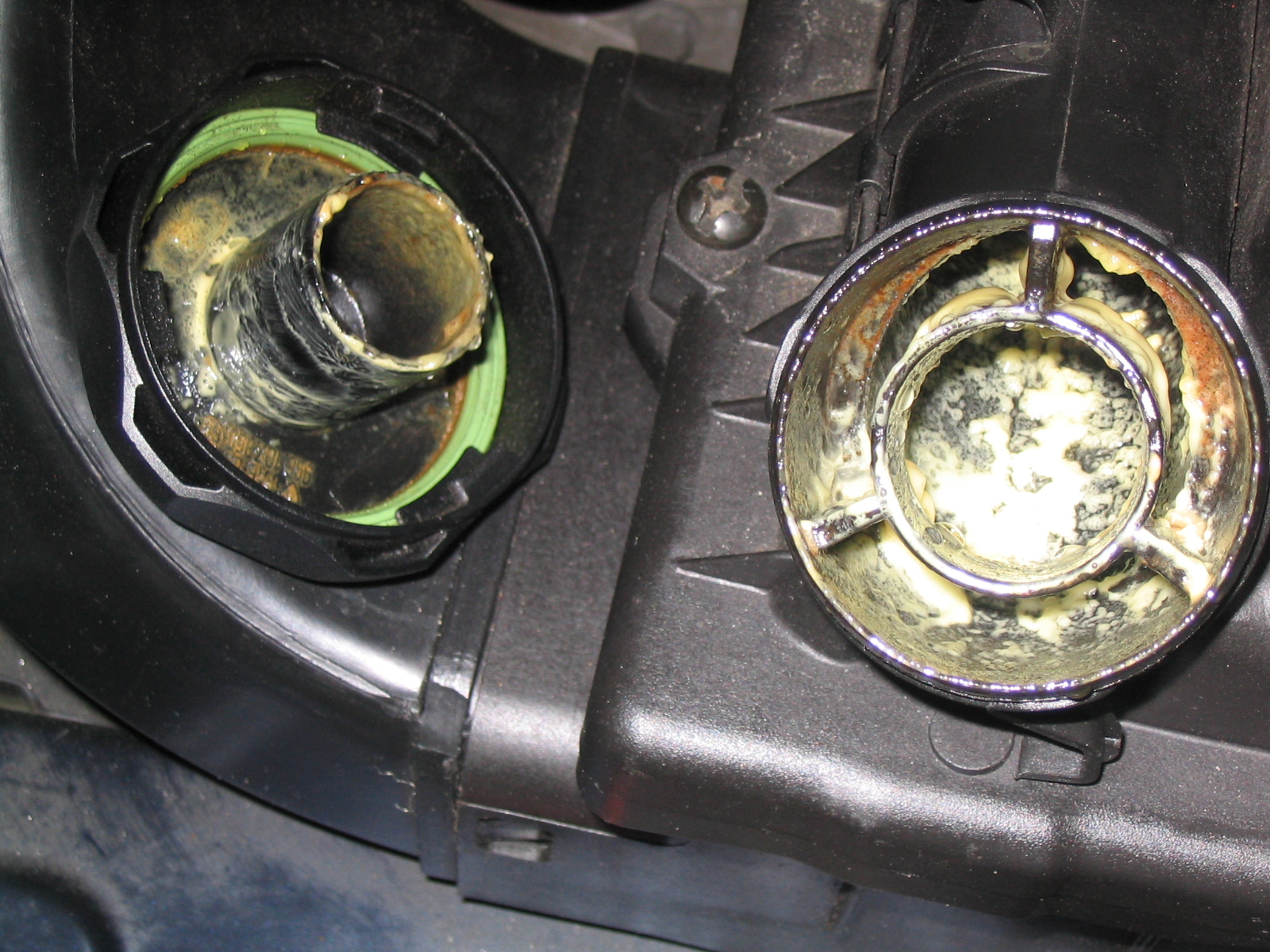

I also notice some moisture in the oil filling cap or something like that.
There is pictures of the coolant tank cap and oil filling cap.

That frothy stuff on your oil filler tube is common. A couple things to check to give you some piece of mind...
Is the coolant in your resevoir clean? Does it look like it's contaminated? Check your dipstick..Is you oil clean? What you don't want to see is oil in your coolant and visa-versa. If your oil is clean and your coolant is clean you don't have a serious issue.

You could have a failing AOS (no big deal repair wise) There are many threads here on that subject.

Yes, AOS is the "Oil Air Seperator". A real common problem on M96 engines. If you do a search in the search box you will find lots of great information.
First of all start you car and try to take off the oil filler cap. If you have a lot of suction trying to prevent you from removing the cap this is a sign of a faulty AOS. Also take off your air intake and look at your throttle body. See if there is oil around the butterfly. If there is that is another sign of a faulty AOS.

Good.. Also I think you need to update your coolant cap to the improved version that ends in "03". It think they are about $12 to $15 bucks online.
Ok,i check for suction and yes,there is a lot of suction.
My throttle body have some oil and is not clean.
I have a real AOS fail on it.......
I will change my coolant cap and look on the forum to know how to fix
my AOS and clean my throtle body and maybe change the air filter.
