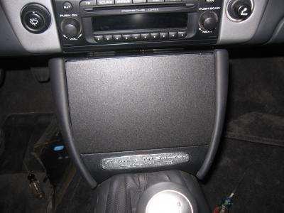

I can't find them either. I've got a couple of pieces of black textured ABS on order...I will try to make my own. I will make a thin plywood template and then try use that to guide the plastic around a router bit. See if that works. Might melt it...not sure.
My prototype. It came out pretty good. The big piece is what I made; the bottom piece is factory. This is 1.4" plywood with rustoleum textured paint.
RennLine advertises HVAC and radio block off plates. But your prototype looks pretty professional!
You could probably sell them to people wanting to add custom gauges and/or switches.
