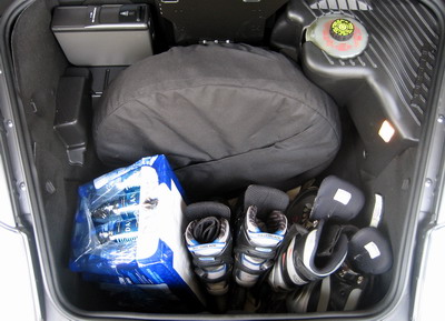

Figuring out if its a 4 is easy. Just pop the trunk and see if there is a front wheel drive mechanism. You'll be able to tell by the presence of the rectangular cover in the middle between the cd changer and disk brake fluid resevoir. In the carrera 2 this will be empty space. Here's what the 4 will look like http://t1.gstatic.com/images?q=tbn:Bj_NS78...m/c4s/trunk.jpg. Also, I believe that the carrera 2 has the spare tire standing upright and visible, whereas in the 4 its on its side in a compartment underneath the floor of the trunk. Here's a pic of the 2 http://www.asphalte.ch/LD/996/996%20trunk%20400.jpg.
