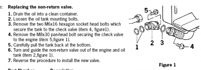

Hi, I'm trying to replace the oil check valve to fix the momentary low oil pressure at start after the car has sat for a period of time. There doesn't seem to be enough clearance to extract the valve from the crankcase even with loosening the oil resevoir lower support. I don't want to force the accordion section of the oil pipe. Any hints? This inquiry might not be necessary if I could find a reasonably priced workshop manual for the turbo, but all thats out there is for the rest of the 996 range, not including our cars. Thanks, Peter
