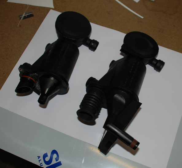

Just bought a 2003 Boxter S with a serious smoke problem. I expected the engine needed replacing but after doing a bit of research i discovered it could be a simple fix. Bought a new air oil seperator from Porsche today and was garaunteed it was the correct one as there was only one that fitted all.
Turns out it doens fit mine so got another one comming in tomora.

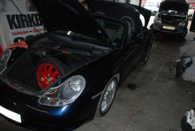

Heres a pic of the car and my valve and the wrong valve.

Ive romoved the old valve and theres quite a bit of oil in the pipes so will let you know tomora.

As you know now, the one on the right is the old style AOS that mounts with bolts through the side. The new one mounts at the base.
You might need to clean out the air distributors, the J tube and the throttle body of oil. Just a clean rag to sop it up. While you are there, since this is an e-gas car, it is pretty easy to remove the throttle body and clean he flapper with carb cleaner.
