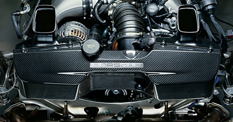

Marc,
If you post a picture of your engine bay perhaps one of us can identify the right connector.
:cheers:
Hi phillipj,
What do you think?
I also looked around and nothing really resembles that brown little connector that was shown.
But it was kinda dark at the time so....
Any help is much appreciated.
:cheers:
Marc

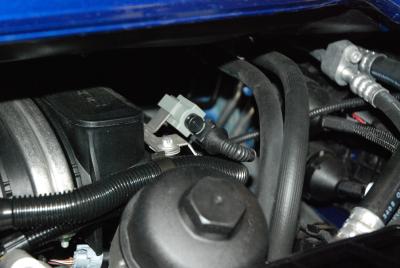

Regardless of the powerkit the solenoid which is a grey item is on the right hand side of the engine and has a small black air line taken from between the manifold on the right hand bank of cylinders. I made up a simple "plug and play" kit that allows you to run a cable back inside the car to activate the PSE via its own switch. This is independent of the 20-40 mph cut out , so the PSE can remain active at all speeds. The simplest location for the switch is either in the ashtray or under the handbrake lever.
The picture below is of a gen 2 997 but the solenoid looks the same. In the picture you posted I'd suspect the solenoid is obscured by the vertical protrusion of the air box on the right hand side

Thanks berty987,
For some reason I thought I was looking for a brown connector... :unsure:
I will have a look and see if the air duct is blocking it. If it is there can I just pull it to disable it?
One more thing, PSE does not switch off at 20-40mph for me. When its on its on and when its off, its just off.
But I guess that really makes no difference right?

Sorry to be a pain but I looked and I looked and I really couldn't find a grey connector like the one in your picture.
I took a few pictures of the area behind the right air box the best I can (you know how spacious the engine compartment of our car is)
and I hope you or someone can make some sense out of it. Please :help: !!
Marc
post-46810-1255960491_thumb.jpg post-46810-1255960561_thumb.jpg post-46810-1255960579_thumb.jpg

http://forums.rennlist.com/rennforums/997-...-a-997-a-2.html
check out post #22... its in a different location. who knew!?!? :)
