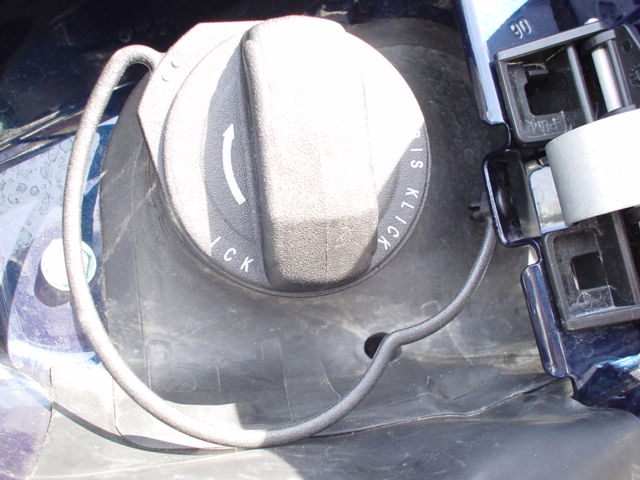

It is easy to tell if you have the new style gas cap since you have a 1999. 1997-2000 caps have 2 slots on the cap to hang the cap on the fuel flap.
There was a recall a while back for 1998 and I think up to 2001 or 2002, a least in California. A sticker was placed on the rear trunk lid.
The style cap for the recall is the cap that started in 2001 with the teather. 1997-2000 did not have a teather. So on those years the teather was removed from the cap, and there are no slots.
1997 was not subject to the recall as 1997 has a different emission system.
First pic is a teathered cap on a 2000. The owner asked the dealer not to remove the teather because there is a hole you can use for the end of the teather on a 1998-2000. Second pic is the sticker for the recall if the recall was done, at least in California.
Well I have the A209 sticker on the inside back deck BUT I do NOT have the gas cap as pictured. I called Porsche NA and they said the dealer did the work. Also I did a quick inspection of the hoses and didn't find any that looked loose or cracked. I'm hoping it's the gas cap. I know a dealer sales manager in another city. I'll ask him what my next step could be. Hint Hint-get another gas cap fer free??

If the recall was done your cap should have in white lettering in German and English "turn to click" with an arrow.  Strange you do not have the cap but have the recall sticker.
Yes I have all of the above except the tether and am thinking the previous owner might have switched it when they sold it.
