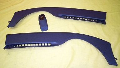

How To Remove Defroster Covers
Remove the visors and the A-pillar trim. The trim just pulls away. Some people also remove the side vents - I do not.
The cover for the alarm lifts up and towards you.
Start pulling up on the dash trim from the middle and work your way to the side vents. Look at your new trim and you will see plastic prongs on the bottom. These prongs go into metal clips under the trim and that is what holds it in place.
If you have not removed the vents then put the new trim in starting at the vent side. At the vent side the trim has a tongue that goes into the vent. This is why some people remove the vent. Stick the tongue into the vent and then start pushing the trim in place, working your way to the middle.
