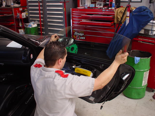

At the top of the door near the seal is a hole throught the sheet metal on each end of the door. You put in a torx bit in the holes and loosen the clamps for the glass, while the window is in the up position.
At least that is what I saw.
tool pants, thanks so much.
To do the window, the clamps need to be removed. The left side one is accessed mid door. The right side must be accessed to at the base of the door behind the speaker. Now all I need to do is find the aero kit wiring instructions.
