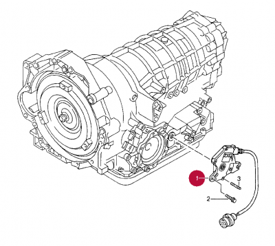

Not sure if this is the part you are referring to, but this is the Tiptronic Selector Switch and is on the transmission. Hope this helps. Included a diagram for you. Part number is 986 325 612 01 for a 99 Boxster.
I would assume this would indicate the position (gear) of the selector and if it sensed it was not in Park/Neutral would not allow starter to turn over?

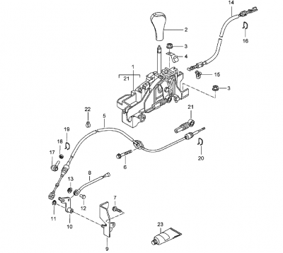

Also included a diagram of the Tiptronic shifter components in case thathelps?
