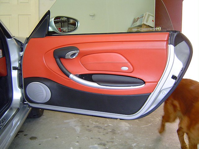

I just replaced the door carpet(bottom portion which I hate most!) with leather that I purchased from local shop. It's just cosmetic change, but it looks way better in person IMHO. Just an idea for those who are looking for another mod.

I did the door carpet(to leather) myself and it's easy to do. As long as you can remove the door panel, it can be done.
1. Remove the door panel (RennTech has the instruction)
2. Remove the door carpet: the best way to do this is using spoon. It took some time to do the first door, but the second took several minutes after figuring out the spoon trick.
3. Use 3M spray to put your vinyl/leather/carpet. use some towel to flat out. Be patient for professional result. (Need 2 person)

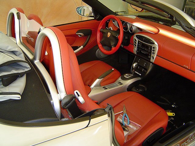

Yes Jeff, the interior carpet was replaced with black by local upholstery and I should have done that myself. (Thank you for the great instructions, I just couldn't remove the bolts on seats with my tools!).
My next project is to replace the ugly 4 spoke steering wheel.
