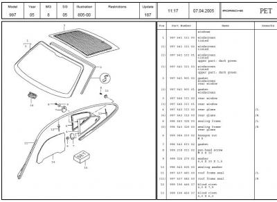

Looks like you would need a rear window sealing frame. Here
is a picture.

Yes, the front and rear window seals are changeable without removing the windows, they just pull out. They should even out first before the window can be removed.
