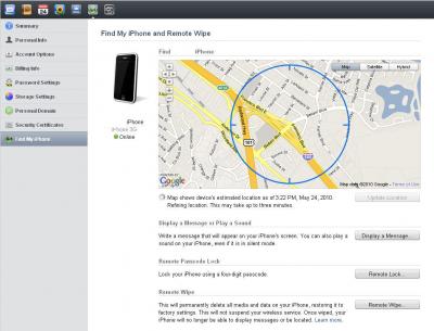

One example is people purchase and hide an iPhone in their vehicle and they track the iPhone via the Apple online tracking tool. It's easy to hide an iPhone and power it -- fuse to low-yield USB. Attached is an example of what the tracking looks like -- my iPhone is not hidden, it's just always in the vehicle, but I can place it under a rug. And if I wanted to hide it in the Cayenne I easily could, I pulled the bottom of the dash above the passenger foot well and there is space, power and reception. You'll be leveraging the cell signal which in the iPhone's case also ties to GPS. You can track the iPhone from any web browser. The attached screen shot is taken from my browser at work. It's pretty cool, you can see the iPhone (if it's in a vehicle) move around. An you can track up to ten iPhones at the same time. If you know how to handle .xml feeds you can build reporting and alerting based on rules you create for where the iPhone goes, time of day, etc.
