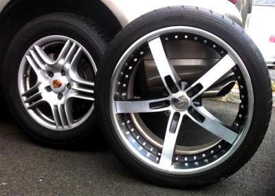

Installed 22s on the Cayenne. Can I still use the spare if 1 goes flat
Lets see some pics with it mounted!
If the diameter of the tires were same, you could. From the pics it looks like you went to a taller tire, so they will not be rotating at same speed and could not use it.
So I went from 18's to 22's and what a diffence! The new stance looks badass! Anyway, if I get a flat tire now, can I still use the spare? I just checked the spare again and it looks like I have to inflate first. :unsure:

I would doubt it would be wise to use the spare for more then a few miles. You need to measure the rolling distance and if they differ more then 5% I wouldn't risk it or you could end up doing severe damage to the differential units.
