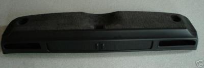

I have searched the forum and can't find an answer to my dilemma. My '02 S is proudly sporting a new GAHH top with a glass window.
My problem is that I had a rear speaker enclosure. My installer has informed me that the glass top prevents the installation of the speaker unit.
Any solutions or do i go without rear speakers.? Thanks for the help.

I am not sure that is entirely true. Which rear speaker unit are you referring to? Bose or standard 2 speaker kit? Do you have the rear compartment? or are you looking to replace the soft leather sport case?
I have a two speaker unit with a storage compartment in the middle. I installed it a few years ago.
My mechanic is concerned that the glass window will break because of the height of the speaker unit.
Any help is appreciated.
While the sound has never been wonderful, the "fill" is really missed.
Nels
I installed a GHAA Top with rear glass window on my 2001 Boxster. It took 2 evenings by myself but saved alot of cash. I installed everything and there are no problems because the window is actually smaller to fit in place behind the speaker unit. That is why your rear view is smaller that the OEM plastic rear window. I would suggest installing it, and make slow movements while stopping to check to make sure everything fits.. Good luck!
