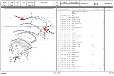

Hello all,
after having an accident with my 2002 986, my car wans't repaired in workshop as it should be done. Because I am the only owner of an 986 in my country, my only hope is to ask you guys here on forum for a pleasure: I need the exact distance between two side parts on the point where the doors are closing. Or, maybe the dimensions of the small lid. Or, maybe both :)
Please help
Bruno

Hi kbrandsma,
thanks for a quick reply. Here in picture you can see what I mean. I have posted a picture The part that I need. Its a part number 1. I need its dimensions.
Thanks a lot

OK sorry. I hope now you can understand what I mean. Sorry for my bad english. I need the distance between this two red arrow
post-62206-018858700 1286126391_thumb.jp
Edited by BrunoX
It is approximately 86 3/8 inches or 2193.9249999999997 mm
