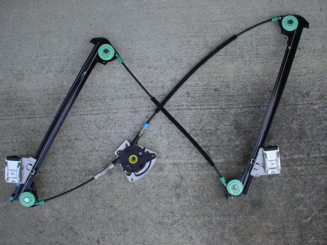

I asked one of the mechanics I know, Manny, at Stevens Creek this very question in September when I watched him replace the window regulator on a 996 in about 20 minutes.
The regulator is operated via a cable. He said it can stretch or something breaks - but otherwise the window goes up and down fine. The cable runs around several plastic pulleys, and the pulleys like to break like in the 996 he was working on. He pulls the door panel off to see what is going on.

So either the regulator itself is damaged in some way or the one of the pulleys is broken?
Or is this all a single unit.  Can the pulleys be replaced individually?

The green round things are the plastic pulleys. They were white on the 996.
The green and blue plastic round things also can break. I think that is what happened to Mark's car. I have a broken regulator with those parts but no clue if you can replace them. A dealer does not play around with this stuff. It is R and R. There are no parts for the regulator.
Thanks for the info Jeff. I will probably take the door panel off and take a look. since everything seems to be working other than the door open function, it must me one of the pulleys. I will see.
