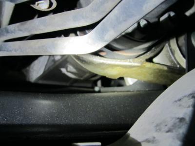

After lifting the suspension to highest position, removed the bottom cover. My friend was turning the wheels, engine running, while I was inspectiing under the car. Could not find any leaks, which is not nice. Would like to know what is it, so I could fix it. (Dont fix it if it aint broken? ;) )
Here is some pictures, first the front differential with yellowish color. Definately not gear oil. Does not feel like or smell like it.

During these 600km, there was no significant loss of steering fluid. The liquid leak earlier on the bottom cover evaporates comletely... I have no smell of coolant or any sign of leaks... Any ideas? I just need to keep driving it until it tells me what is wrong, I quess.
P/S fluid doesn't evaporate but coolant does. Have you checked all fluid levels? I would suspect you have leaking coolant pipes under the intake manifold. The "V" between the cylinders can hold a lot of fluid and the leak appears to come and go as the level as collected coolant spills out and then refills.
