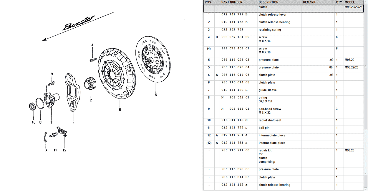

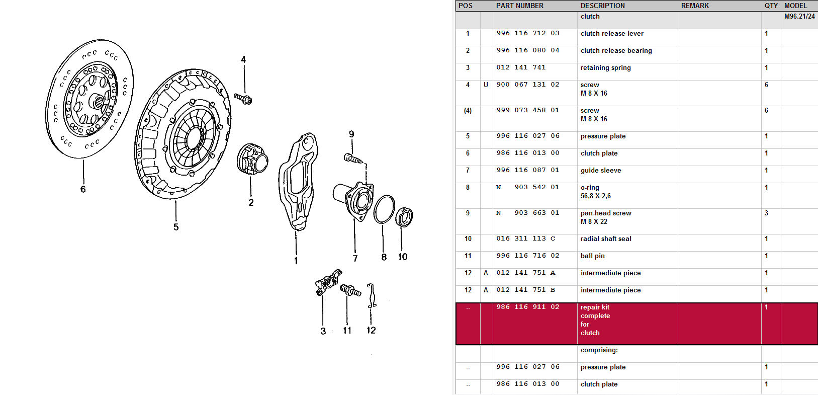

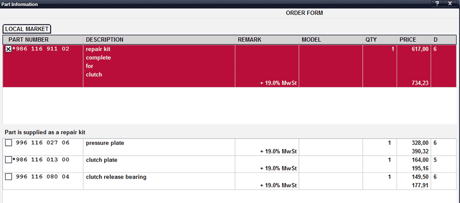

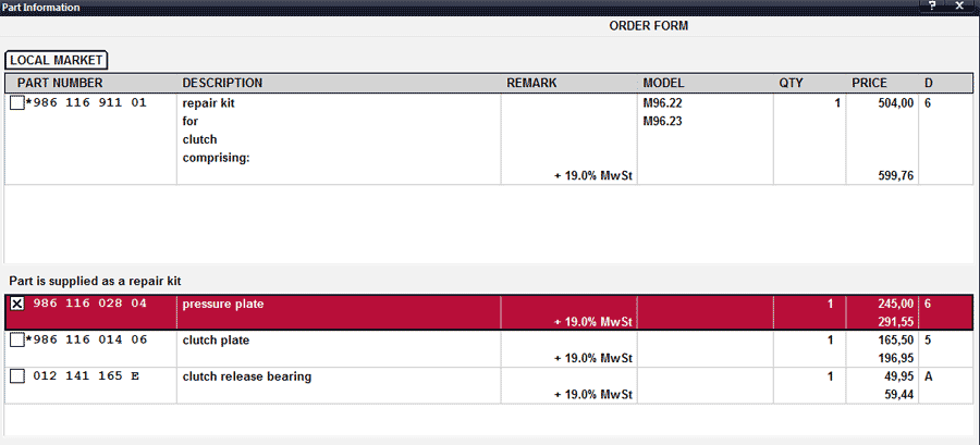

HI,
I have attached the parts lists for you. This should give you everything you would need. Just make certain you pick your correct version. All parts are for a 2001 Boxster.
Good luck.
DC
