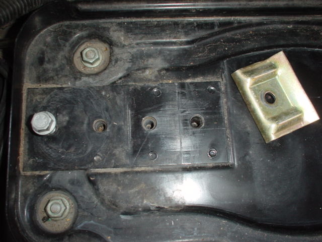

Read my message #13 here. http://www.renntech.org/forums/index.php?showtopic=2950 On the 1997 Boxster the last hole is threaded. For 1998 up the hole is there but there are no threads. The threads for that hole were eliminated for some strange reason. You can put a metric nut under the unthreaded hole if you want to use the 49. If you do this do not drop the nut or it might go into the water drain hole that is near the battery tray.
Here is my 1997 battery tray and all 4 holes are threaded.

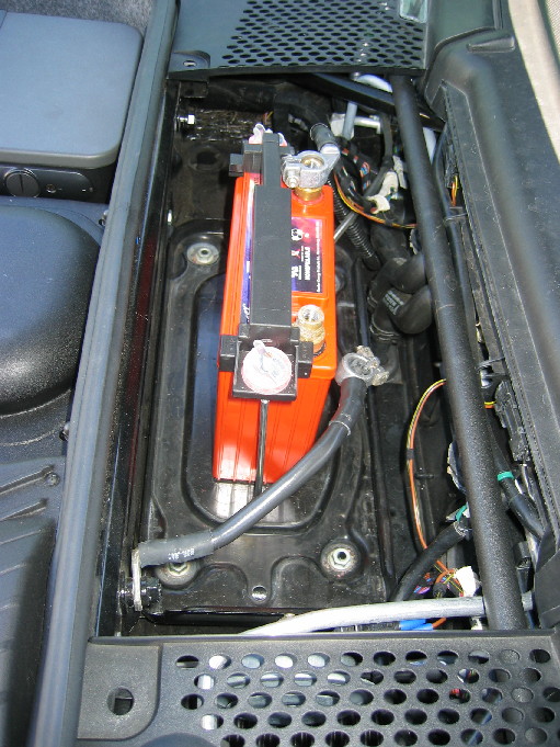

The smallest battery is used on the GT3. I think your turbo has PCM so it gets a bigger battery.
In Texas you can probably use two flashlight batteries. This is what Alex has on his 2001 turbo.
