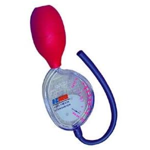

You could get a cheap coolant hydrometer at any auto parts store and check the concentration of the coolant, but I'm sure it's fine, esp. for FL driving.
