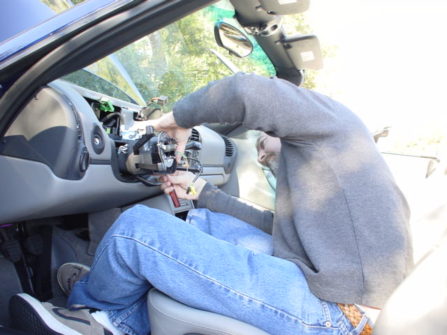

I cannot answer your first question but $2400 is ludicrous. I did mine without the stalk for about $50 (swithc on the dash). If you want the stalk instead of the switch, then talk to ToolPants. He has done numerous OBC retrofits and can tell you the cost. I would say less than $500 but dont' quote me.
I assume you sent your dealer Peter Smith's instructions for a 2003. I have known Peter for 6 years as he works at my local dealer. Each year when a new model comes out I ask Peter to try and turn on the trip computer to see if anything has changed, as our local group has done many OBC retrofits. That's how we found out the issue with some 2003s - for some strange reason the vehicle model number was not in the DME. When the model number was entered then Peter was able to turn the OBC on.
When 2004s first came out I asked Peter to turn on the OBC and he did.
As of 2002 the standard instrument cluster is different than the cluster with the OBC option. If you do the retrofit on a 2002-2004 with the standard cluster then the displays you see look like a 2001 with the factory OBC. On a 2002-2004 if you want the displays to look like what is in your owners manual then you have to buy and install an OBC cluster.
I suspect the price you were quoted includes replacing your standard cluster with an OBC cluster and that is why it is so expensive. Call your dealer and ask what parts are included in the quoted price. We do the retrofit using the standard cluster as an OBC cluster is very expensive. The stalk, wires, and connector are about $170. I can do it in less than an hour if the owner is not helping. :lol:
This OBC 'hack' is not an official retrofit. There are no Porsche instructions. The mechanics are not taught how to do it at their training school. Some dealers still say it cannot be done on a 2001. A while ago I was at a dealer that Peter did not work for. The service guy told me the retrofit would not be done as of model year 2001. I told him it could because I had done it on cars newer than 2000. Gave him the instructions. Then he told me they did 1 car and it worked, but did not think they would be doing any more cars.

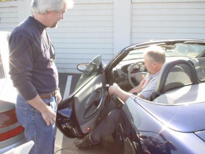

I have no advise other than to bring your car to sunny California or find someone locally that can help you. I get Peter to turn on the computer for the local owners. Then we do the retrofit at our local work on cars day.
A long time ago we filmed the retrofit on 4 different cars, including a 2003, so I would not have to answer all the questions as each model year comes out. Stalk, switch, year - does not matter.
This is Peter turning on Scott's computer on a 2003 S over 2 years ago, and then we did the retrofit in the parking lot at Scott's office building at lunch time. Nothing changed for 2004.
