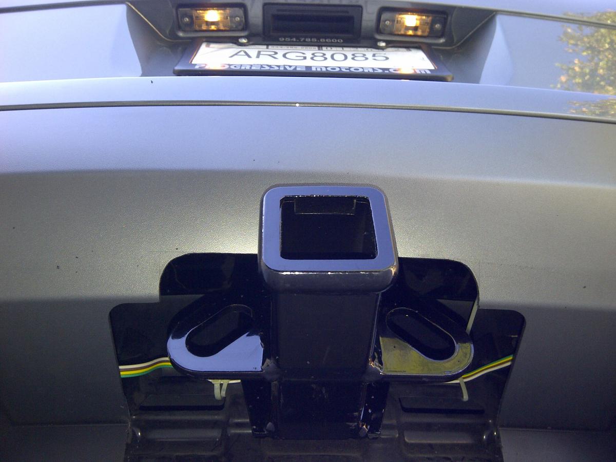

Just to follow up on my hitch installation. I used the Curt trailer hitch and the Curt power converter module #56146. The power converter is not listed as available for the 09 Cayenne but through emails with Curt they said it works for the 08 so I deciced to try it and it worked perfectly.
For anyone thinking of installing a hitch on their Cayenne 09 S if you don't need electric brakes the after market route is the way to go. The hitch cost $174 and the power converter is $19.00. It takes around 3-4 hours doing it alone. The hardest part is cutting the bumper. Actually the cutting is easy, it is the planning and making sure not to screw it up that takes the longest. I put the bumper in place, marked it and cut it a few time because I wanted the opening to be a small as possible. Other posts indicated that the bumper needed needed to be "trimmed". Well on the 09 it has to be cut. I'm attaching pictures to show the way I cut the bumper.
Another hint is that there are two screws, one on each side, under the wheelwell rubber that need to be removed that aren't plainly visible. If you remove all the visible screws and the bumper cover is still firmly attached look under the rubber and you will find these screws. Then it will come off easily.
Thanks to all for their posts regarding the hitch installation. Again this website has provided fantastic information!
