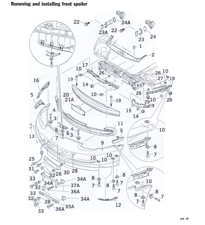

A semi truck cast a piece of its retreaded tire right in front of me and it made a small hole in my bumper.
Unfortunately it also damaged the plug that the ambient temperature sensor goes into.
My local Porsche shop has tried finding the part number for the plug and have been unsuccessful.
They have also tried calling Porsche Germany and that hasn't worked either.
It has been 2 weeks and still no luck.
Any ideas or a part number to look up?
The sensor is number 25 in the attached picture, but I need the plastic plug that it goes into.
Thanks!
post-58543-0-99073800-1326580409_thumb.j

That pic shows a wiring harness on both sides, with similar prices.
I thought the ambient air temperature sensor is located only on the passenger side?
