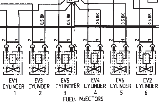

and edit: I see there is only one size oring available, so I'm guessing they will fit... but not sure about wiring to the injector, voltage or impedance, can't see why it would be different though, just a two wire injector. Can anyone with a 2002+ wiring diagram see if the wiring is the same as the 1999?
Heres the 5.2.2 wiring
and 7.2
Not sure about DME 7.8 though, although interesting PET says the white injectors are good for 01 up which includes 3.4L cars. Strange.
