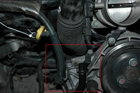

While working on the alternator broke the hose inside the red square. Can it be spliced or it has to be completely replaced?

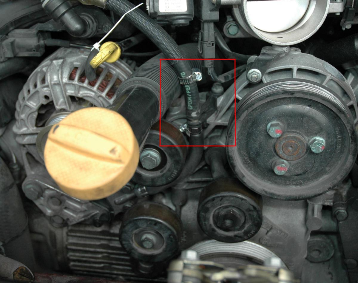

Took the initiative of doing what you suggested before waiting for an answer. Drilled a bigger hole in the retaining arm and put the brass coupling through it. Think the retaining arm is to prevent the hose to touch the roller.

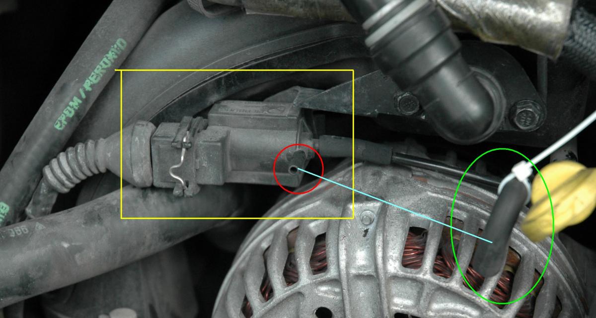

Loray, do you know what is this inside the yellow square?
While working on the alternator had to disconnect the two hoses. When I went to reconnect them, the one inside the green oval that goes connected where the red circle is, the other end is not connected at all. Don't know if ti was like that before working on the alternator or I disconnected it by mistake.If it was disconnected before working on the alternator I have not experience and/or notice any malfunction. Tried to see where the other end goes connected but was not able to see.

I had the same issue with that plastic coupling breaking when I tried to remove that hose. I had a spare hose coupler already on hand and did that with some tie wraps until I got the actual part from the dealer (a $5 part IIRC). Nice work.
Thats the change over valve for the intake resonsance flap, operated by vacuum at different RPMs.
The hose you are pointing out goes into the tube that operates the flap.

In order to re-connect it, does the alternator has to be removed, or parts #9 and #13?
Can the car be driven without re-connecting the hose, what would happen if it not connected?
You can reconnect that hose "by feel" and using a mirror and light if you remove the throttle body and t-plenum just behind the T/B. Then reach into the back of the engine.
There is no danger, you can drive the car without having that hose connected, although power (or engine noise) might be a little down or abnormal.
Also with that hose disconnected the engine will have a small vacuum leak. You could temporarily plug/clamp the outlet circled in red to prevent the leak until you can fix it.
Went for a plug. Too much hazel removing the t-plenum, did clean the throttle body though.

When you do get the time, you should considering fixing it... but it's not critical, take your time if you've plugged it off.
When you remove the throttle body that will give you a good opportunity to very thoroughly clean it.
Then just pull the t-plenum behind it and you can reach around to re-attach that tube.
