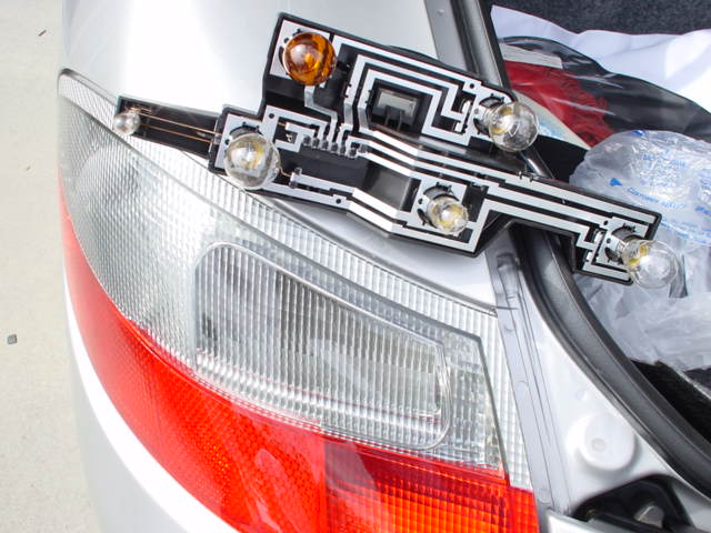

ok, easy enough. unfortunately, i have a new problem. the passenger side was the side with the light out. when i pulled it out it i was actually missing a bulb and i was curious to see if there was actually supposed to be one there so i pulled out the "bulb holder" piece from the driver's side to see if i had one over there. when i was taking it out (a much tighter squeeze) the whole thing went out!! so i jiggled and unplugged and plugged back and so on and so forth but nothing. i switched "bulb holder" between left and right and it still worked when plugged into the other side. that means it had to be wiring (probably the harness) but i was wondering if anyone could give me a little bit more advice. i don't have a multimeter so i can't check it. thanks for your help.

it's a LHD. i thought it was a brake light. i agree, i may have done something for nothing and am now in worse shape than when i started. regardless, nothing on the driver's side is working (except the brake light). that is, when i turn the lights on, nothing on the rear driver's side works until i press the brake and the brake light comes on.
it stopped working when i was taking the drivers side holder out. i pressed the tab and started trying to work it out. all the sudden it went out. very strage.

yeah, that's the one i'm having trouble with. i'm just going to get a multimeter and try to pinpoint the problem. i now noticed that the blinker and the brake light work on that side (not sure about the reverse light, i need a helper) but the "running lights", i.e., lights that are on when the headlights are on, still do not work. i must have just loosened something in that connector when i was pulling it out. it sure seemed sensitive, i just hope something didn't break at the other end of the wire. you don't happen to know where the wires from the connector lead to do you?

hey toolpants, can you tell me where the wires run to FROM the connector at the bulb holder? does it go to the fuse panel? i checked the wire just past the connector (on the wire side) and there is no voltage there. so, i have ruled out the bulb holder and the wiring in the conenctor as the cause of my problem. that is bad since now the problem could be anywhere between the connector and the power source. if i can find the other end of the wires then i can check the voltage there and try to trace the problem back. are there any diagrams available for this? thanks for your help.
