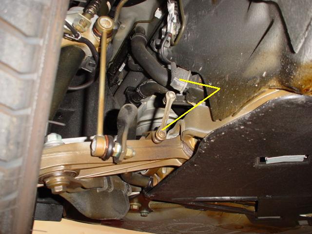

With the factory installed lits there is a sensor on the left front and left rear suspension. There is an electrical connector to the sensor. Check to see if the rear sensor is hooked up.
I can't find a good picture of the rear sensor. This is the front but the rear looks just like it.
Thanks Toolpants! The rear sensor does look the same (Did'nt think there were 2 of them). I tried to disconnect the plug from it but its awkward to disengage the retaining lugs & get a good grip to pull it off. I don't want to break it off :-) But I will check out the front one tomorrow, maybe it was disconnected? I'll keep you posted. I have to take the car back in 2 weeks for a warranty repair, (slight coolant seepage at the LH cyl head gasket - apparently a known fault?) so if I still can't fix it my shop will. They are really good, Raffay Porsche Hamburg Nord, recommended to Porsche owners in Northern Germany.
