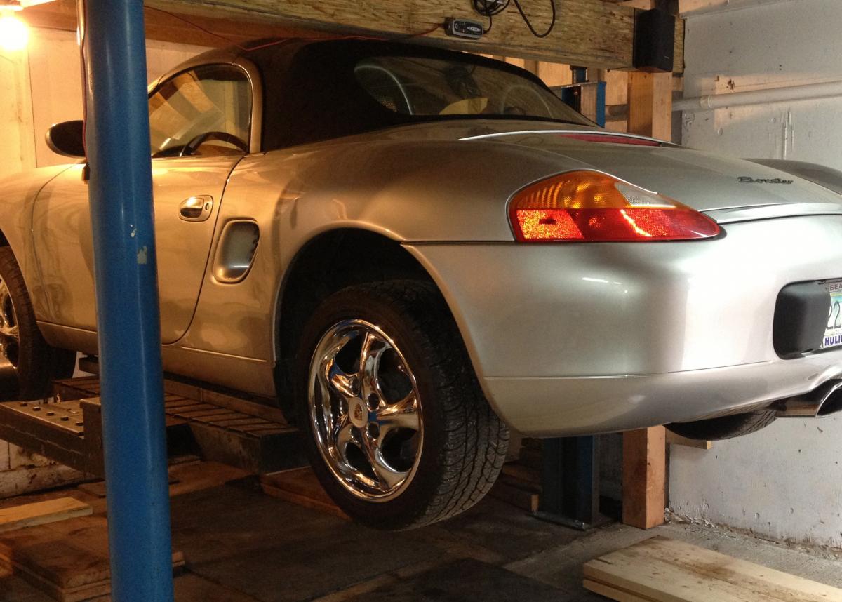

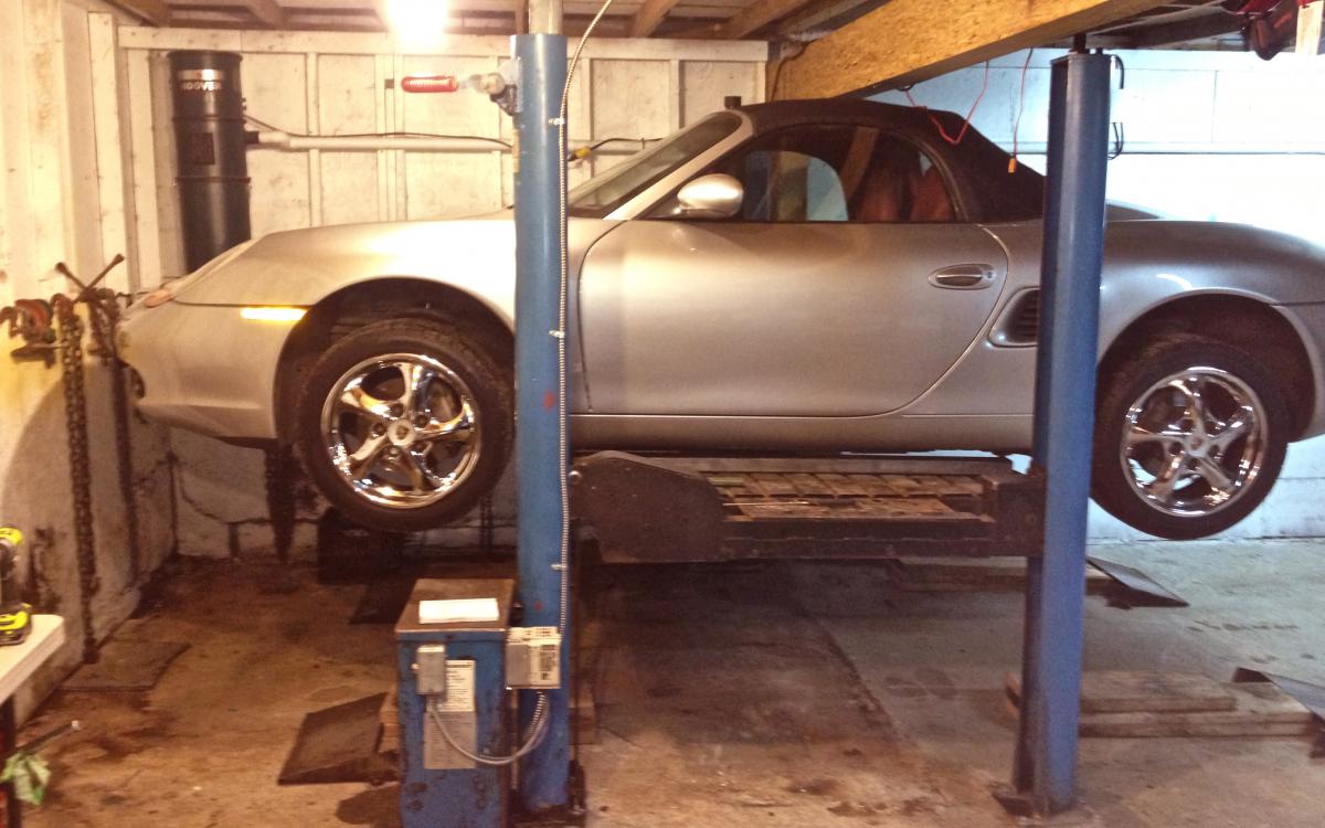

Installed a 3 post Bradbury hoist for my boxster.
Installed this hoist in my 2nd garage for my boxster. It is an oldie but a goodie. Easy to get at engine and transmission.
Paid $400...1977 Bradbury 3 post.

Wow, that's just fantastic! I'd jump on that in a heartbeat if I could find one for $400 like you did. I'm fortunate enough to have access to lifts at a local auto hobby shop, but nothing beats that sort of access in your own garage. What sort of structural requirements does it have for installation?
Edited by grover
Share this post
4" of concrete, has only 1 hydraulic cylinder and 2 sets of cables for the other posts. 220v 3phase motor that I am running on 220v single via an inverter.
built a set of lift bars that match the the lift holes of the car. I have seen 4 post and 2 post Bradbury's but never a 3 post...

Bradbury of Braintree! I've not seen one of those in ages. With no load on the lift inspect all the cable pulleys for wear and play in the axle bushings as it's a common point of wear on these older lifts.
Share this post

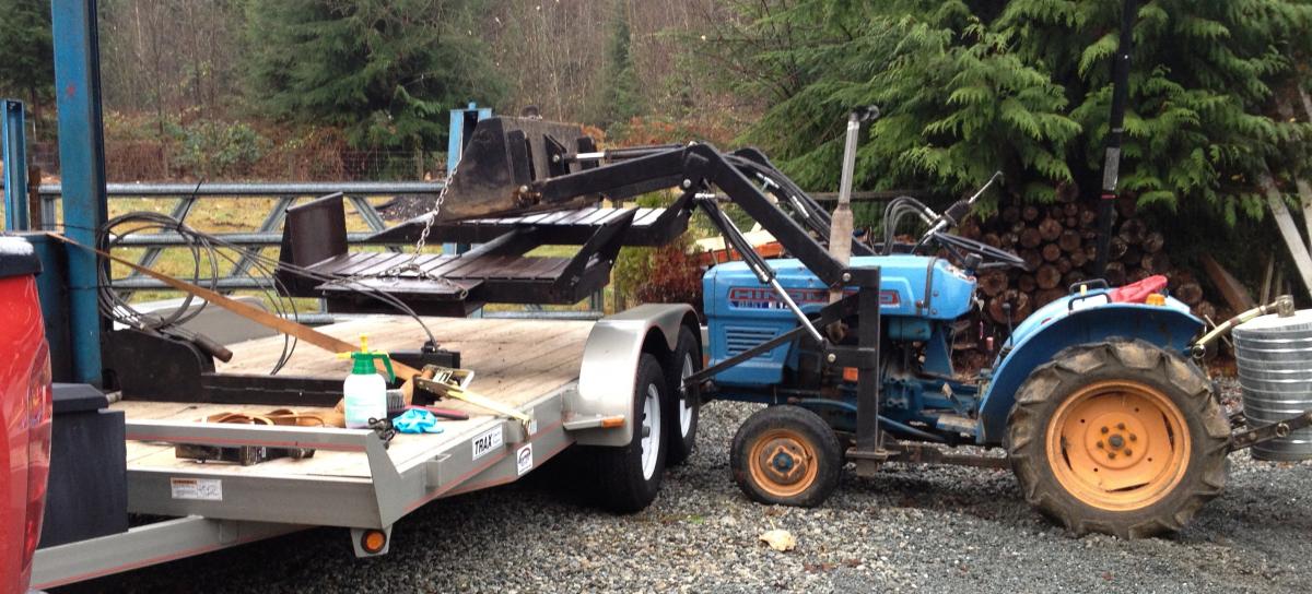

Thanks, I did...it was well maintained and working in a small Foreign Car specialist in Vancouver. The garage owner was 8 when his father had the lifts installed...he made sure he sold it to someone who would use it and not scrap it. Here's a picture of how I unloaded it.
