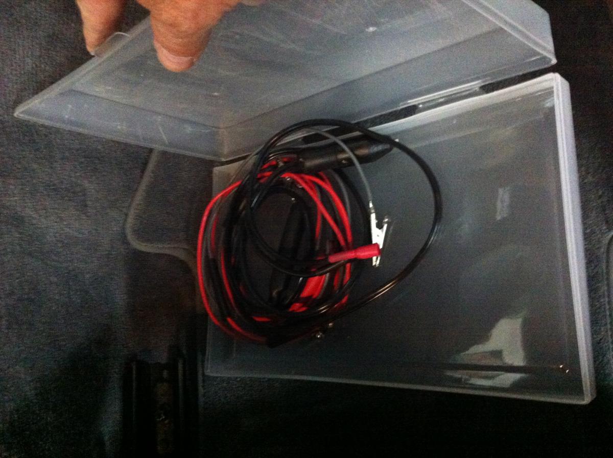

I went to autozone and purchased a cigarette lighter charger for $20, (this was after 3 shops, call first,) plugged it into the AC an the other end into the lighter, after ~10 mins it finally had enough power to open the trunk, voila. I then used my regular charger to charge the battery.
One thing to note, is that when u use the charger, u have to give it some time to recharge the battery, I got the lights back on my dashboard str8 away, and the interior lights, but I would hit the trunk release and I would hear a bunch of whirring but it would not release. Like I said don't panic, give it some time to charge ~10 mins and it will release. In fact the engine release worked first after 5 mins.
