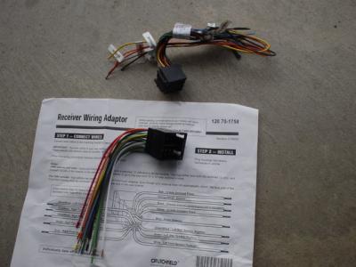

The top one was in the Traffic Pro box when I bought it from Crutcfield. It is male.
The bottom one was included by Crutchfield for free in the shipping box when you bought a Traffic Pro from them. It is female. Listed as a VW/Audi harness 120701758.
Not sure if that is what you are looking for.

Nevermind. I just confirmed it. The Yellow C1 plug is the pre-out to the factory amp. The 4 channel amp does not have fade.
The diagram posted of the trafficpro's print out is also a little off. The subwoofer positive lead is not a subwoofer lead (pin 6 in C1). This is the remote amp connector to turn the amp on and off.
